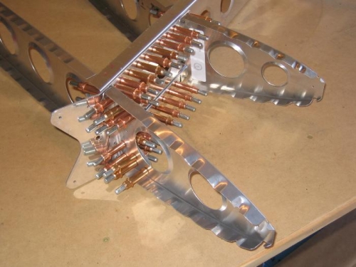

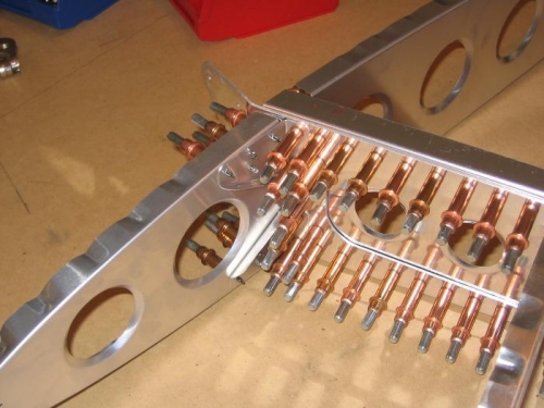

Assembled Front Spar Assembly
Identified parts in the Vertical Stabilizer Assembly.
Pressed Flange Bushings into the upper and lower Vertical Stabilizer hinges.
Assembled the front spar and transfer drilled all holes to #30.
