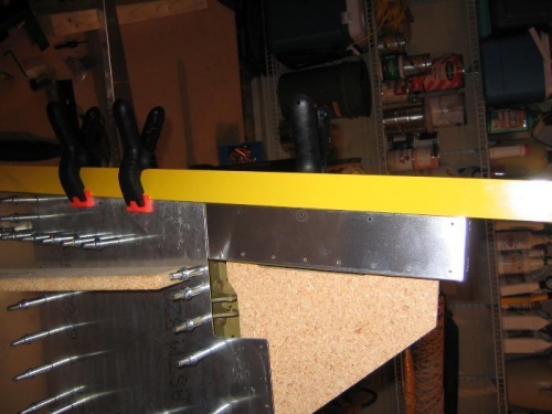

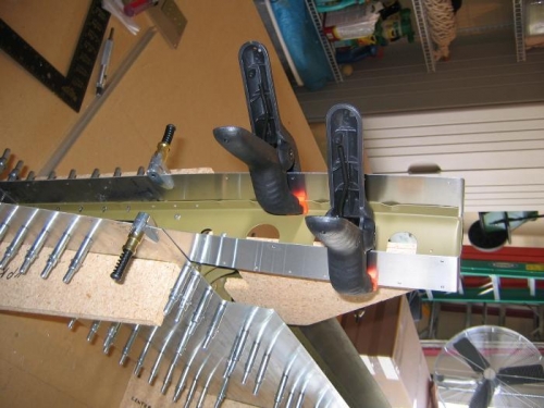

Used an aluminum yardstick as a straight edge to align the rudder strap with the rudder skins. Used spring clamps to hold the rudder strap in place while transfer drilling.

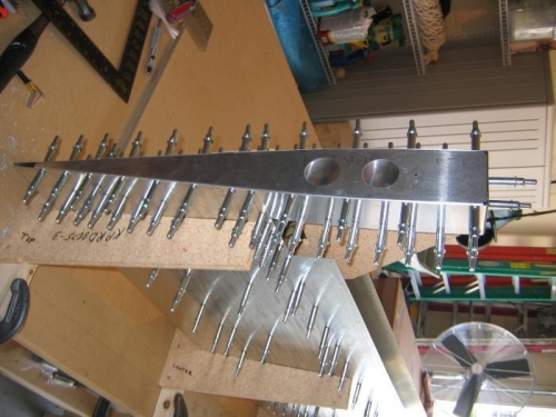

Aligning Rudder Strap
Rudder Strap Clamped in Place
Clecoed Rudder Strap
