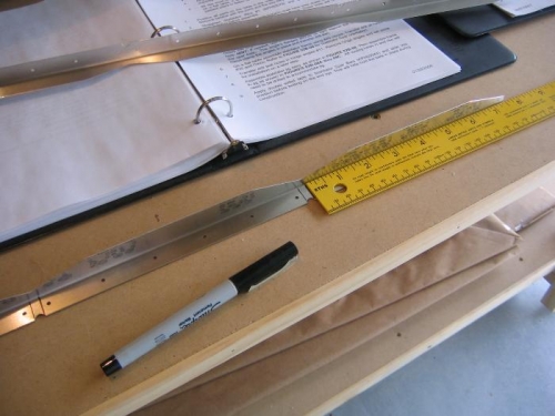

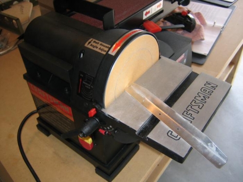

Cutout the rudder skin stiffeners from the raw material. I used my 3" pneumatic cutoof tool and it worked great. Then used a disc sander to finish the edges and round all corners.
Marking Stiffener Raw Material
Finishing Edges on Stiffeners

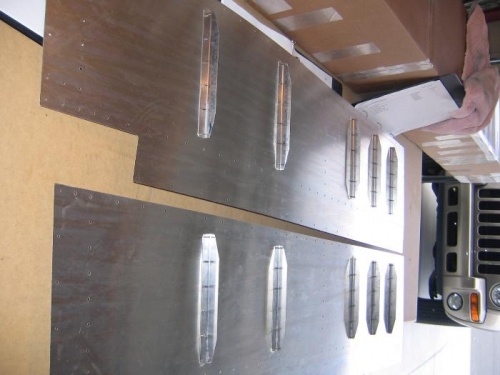

Stiffeners Clecoed in Place
