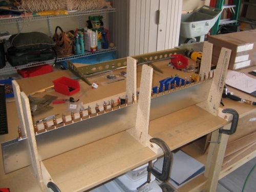

Brief Description:  Transfer Drilled and Clecoed Trailing Edge
Using my enhanced rudder jig, I transfer drilled and clecoed the leading edge of the rudder trailing edge assembly. There is a slight taper in the width of the overlap on the leading edge of the rudder trailing edge as you move from root to tip. The enhanced rudder jig that I designed maintained this taper superbly! There is no "wavering" in the overlapping dimension as you move from root to tip.
Leading Edge of Rudder Trailing Edge
