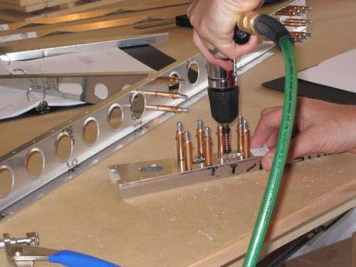

Brief Description:  Transfer Drilled #30 Holes in Rudder Frame
I received my Chicago Pneumatic Air Drill, Model 7300RQC (reversible, Quick-Change chuck). I love this drill! It is lightweight and the trigger provides good control when starting. I like the Quick-Change chuck (I don't think that I can live without one, after using one on my Dewalt drill).
Also, I bought a polyurethane air hose. I read in a recent issue of a Handyman magazine that one of the 10 best "tools" to have is a polyurethane air hose for your compressor. They are flexible, lightweight, and do not kink. I really like the one that I bought at Home Depot.
Transfer drilling went fine. I was impressed with the precision with which the #40 pilot holes lined up...RANS has done a good job.
Transfer Drilling Rudder Frame
