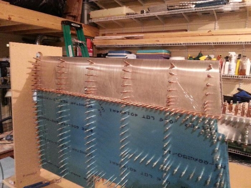

Brief Description:  Drilled and Clecoed #30 HS Top Forward Skin
Drilled and clecoed #30 the HS top forward skin. Started at the center of the stabilator spar and worked outward. Then worked from the stabilator spar forward to the leading edge of the skin.
