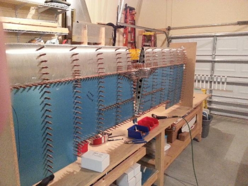

Brief Description:  Drilled and Clecoed #30 Stabilator Bottom
Drilled and Clecoed #30 the bottom of the Stabilator.
Discovered in this step that I had mistakenly drilled and clecoed the HS servo tab hinge doublers to the rear spar. This step should have been delayed until after the servo tab hinges were fabricated. I will order new doublers.
