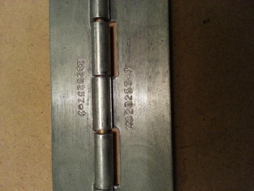

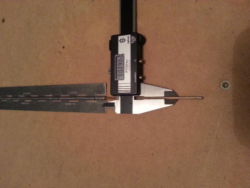

See photos below. I verified that I received the correct hinge in my kit.

Hinge Pin Measures 0.090
Hinge Stamped with MS20257-3
