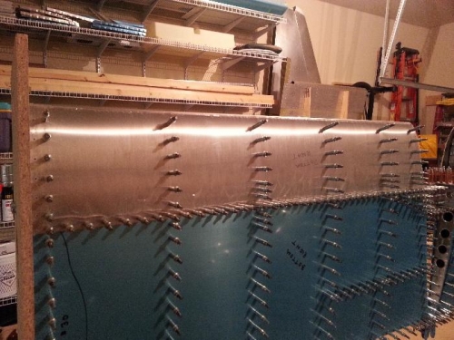

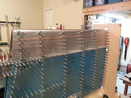

Brief Description:  Drilled and Clecoed Right Forward Skin to Ribs
The photos for this log entry show the right forward skin after it has been drilled #40 and clecoed to the forward ribs.
On the top side of the right forward skin where the skin wraps around the most inboard of the ribs I noticed a slight "bump" where it appears that the edge of that rib was not sufficiently trimmed. I marked the area on the skin and on the rib (since it was an inboard rib it was accessible from the opening). When I remove the clecoes for deburring the skin I will tap out hte small "bump" in the skin and trim the rib.
Top Right--All Drilled and Clecoed
Bottom Right--All Drilled and Clecoed
