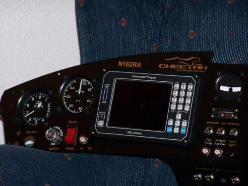

Our panel design is a combination basic panel that includes a gps moving map with the Stratomaster enigma as well as some basic steam gauges.
The panel was cut out the old fasioned way with a hole cutter and drill press and drill and jigsaw.
Spent most of spare time in December working on the panel.
panel is 2.5mm thick and is pretty stout.
The airspeed, altimeter, slip indicator and the amp/volt meter are set up with nulites in order to provide lighted instruments. The dorky looking aluminum thing above the radio is a cockpit red light that is directable to different places. Not quite sure I like it. will see!
Panel on left side
Panel on left side

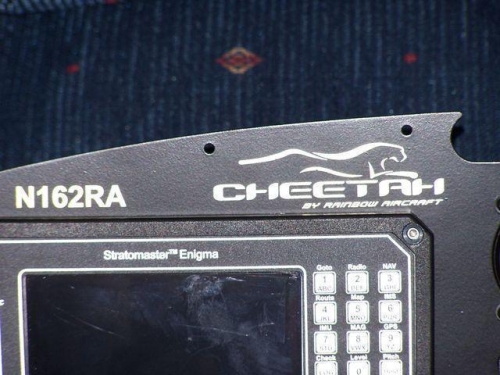

Panel decals using decalprofx

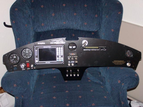

full view
full view
