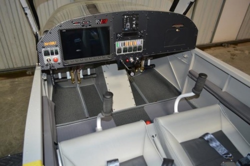

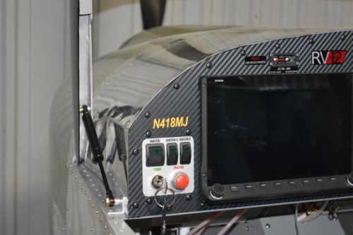

Brief Description: Add N number to interior (PAP - G9)
I didn't spend too much time out at the hanger today, but did complete the panel with the N number. I also added the vent hole(s) to the cap. I realized after much research that my trim motor was operating in reverse. The linkage and positions all matched the PAP directions, except nose down and nose up were reversed. I'm not sure how I messed that up, but I was able to pull the EFIS out and switch the wires (31 & 32). Now it's working the right way. It looks like trim center is set up correctly as well.
