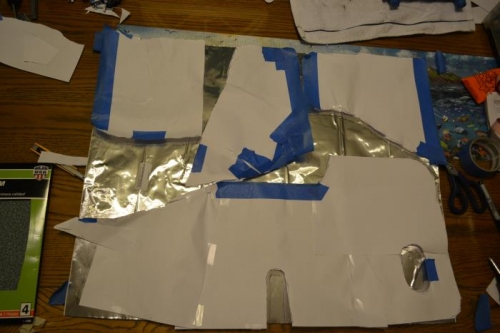

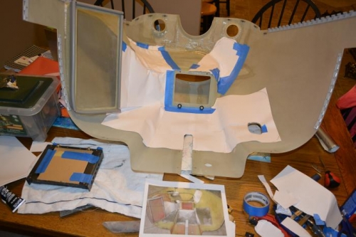

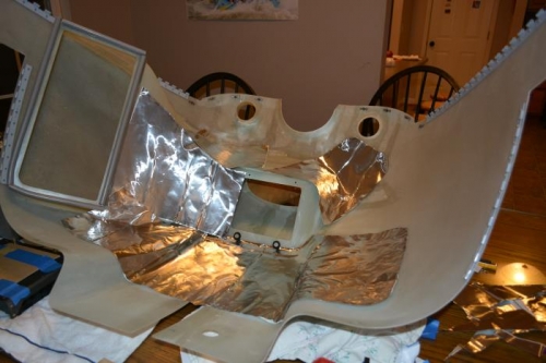

Brief Description:  Prep for heat shield (49-16)
Next step is to create and attach heat shield. I used paper to shape and lay down the template. Then I slid the lower cowl on to the plane and checked to make sure the template was positioned correctly. I then removed the templates and place them on the heat shield. I had to make a few adjustments to get them to all fit, but I figured out. Now I’m just doing a dry fit and will stick them down tomorrow.
created heat shield templates
layed out templates on heat shield
dry fit heat shield
dry fit heat shield
