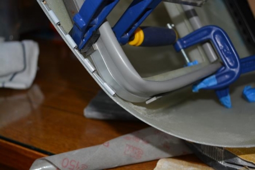

Brief Description:  Attach remaining air duct seals (49-15)
The Permatex seemed to stick well from the first seal, so I went ahead. First lesson learned...don't ask your wife to help hold the seal in place while you apply clamps, when she's wearing nice clothes. Somehow she got the silicone all over her hands and sweater. Needless to say I learned my lesson. Anyway, the remaining seals are now attached. For the long piece I used 2 steel bars for the sides and a left over aluminum hinge (minus the tabs) to apply even pressure around the curve. Everything seems to stick well and is in place.
last seal clamped in place
added curve brace to help apply pressure around corner
seals complete
