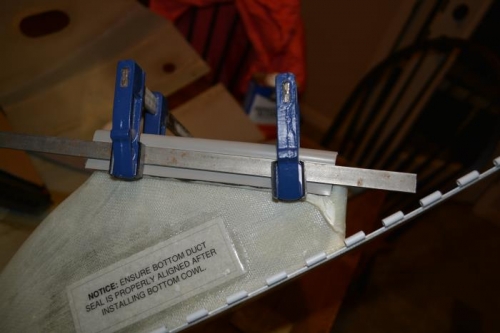

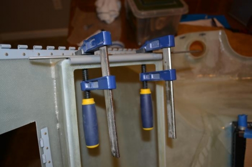

Brief Description:  Air Duct Seal (49-15)
After cutting the seal to the prescribed lengths and picking the silicone sealant after much blog research, I proceeded to attach the first seal. I found a steel bar that worked pretty well to help apply even pressure across the entire seal. I’ll let this completely cure before proceeding with the next seal to make sure that this works and holds.
1st seal set in place
Added steel brace to apply pressure across entire surface
