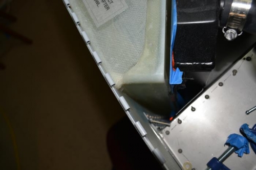

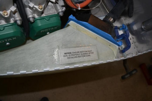

I mixed up a little resin/flox mixture into another cake decorating bag and filled al the holes from the clecos. I also added some filler to bridge some of the lager gaps to give the fiberglass some more strength.

filled cleco holes
filled cleco holes
added some resin/flox mixture to gaps
