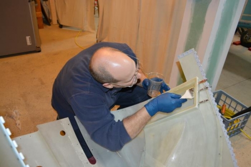

Now that I have the technique working I just needed to apply a few strips of fiberglass around the transition areas. The transition piece had some big gaps that the strips needed to bridge across, but it worked out well. I’ll probably back fill with some resin/flox mixture to give it a little more strength.

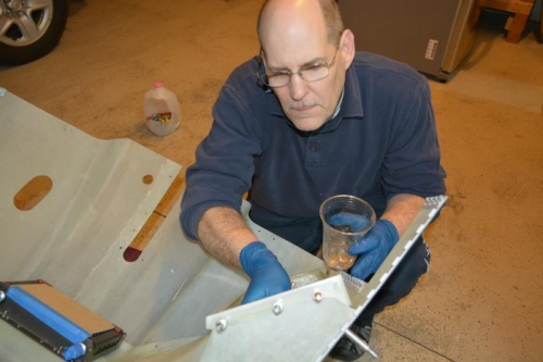

Fiberglass/plastic wrap sandwich
attaching fiberglass to tansition piece
