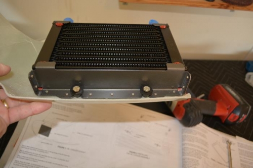

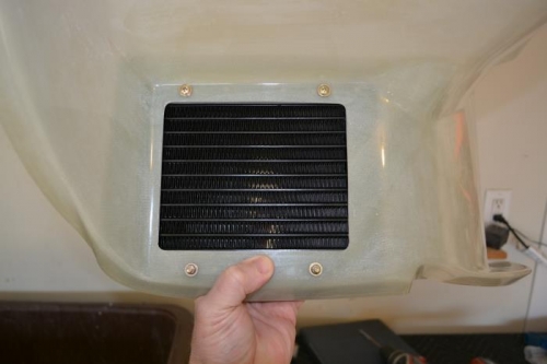

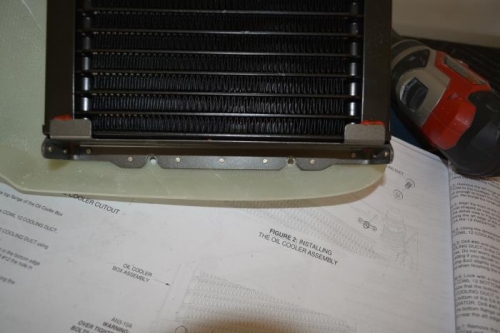

With the upper screws in place I drilled the lower holes through the guides, I then added the bolts. I tightened them down just enough that the guides wouldn’t rotate with the oil cooler removed.
lower holes drilled
cooler guides attached
oil cooler attached
