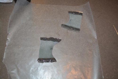

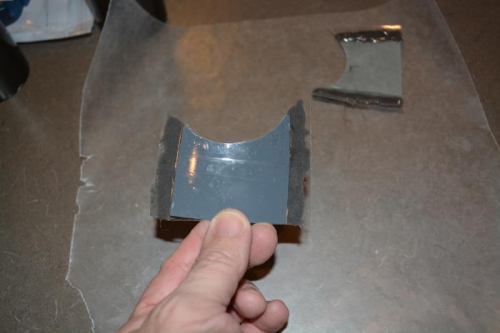

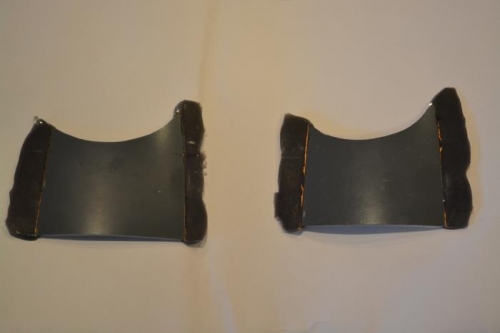

I wasn’t happy with the gap between the edges of the spinner gap fillers and the spinner, so I added some resin flox to each of the edges. I first cover the outside with some clear packing tape and let it over hang so I could keep close to the same contour. I then laid down another piece of tape at the edge to cover up the sticky portion of the exposed tape. I added some car wax to this surface to keep the resin from sticking. While I was prepping the edges, I was letting my resin flox mixture set up a little. I added a tiny drop of black die, which gave me a gray mixture. Once it was fairly stiff I added it to my edges. Once it set up for a while I placed some wax paper on the inside surface to try and smooth it out a little. I gave it a day to dry.
added some resinflox mix to the edges
taped outside to create shelf for resin
added material dry
added material dry
