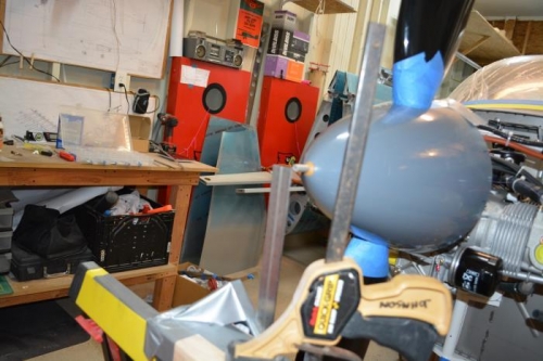

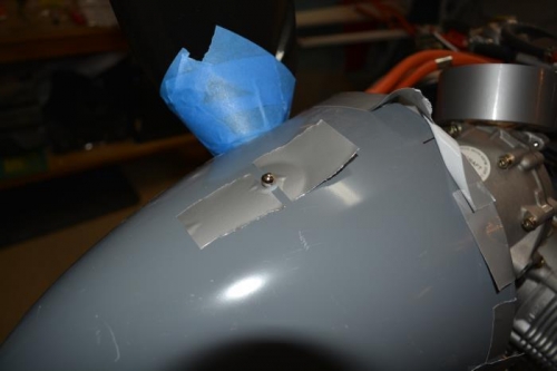

I finally received enough spherical magnetic bearings to complete the spinner installation. The change to an opaque spinner means that we need to use this cool idea of magnetic bearings to find the holes. So in reading section 5 I saw that I could order these from Vans. Well I assumed I would get a set of bearings, but the first delivery I only got one. Lesson learned; don’t assume I will get enough to complete the job. So after I received another order of 5 bearings I was able to complete the job. Cyndi was able to help me center the spinner, which worked great. She down in front of the spinner and I rotated the prop, adjusting the spinner until it was completely centered. Then I tried to tape it in place, but I think I should have used some cleco clamps as well. Next, with 4 bearings taped to the inside underneath the holes I used a nylon washer and the two remaining bearings to find the correct position. This was so cool, that I actually videoed the bearing sliding into place. Then I taped down the nylon washer.

Cyndi helping with the spinner alignment
home grown spinner alignment set-up
cool magnetic bearing to find the holes
