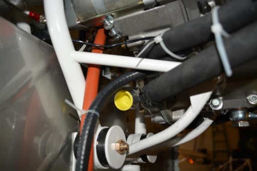

aft Adel clamp
aft Adel clamp

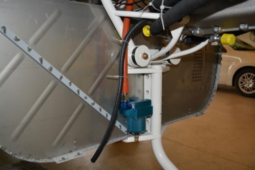

aft hose routed out
aft hose routed out

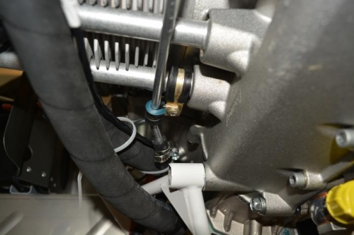

loosely secured and I'll cut to size later
