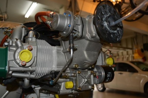

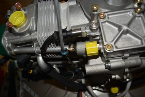

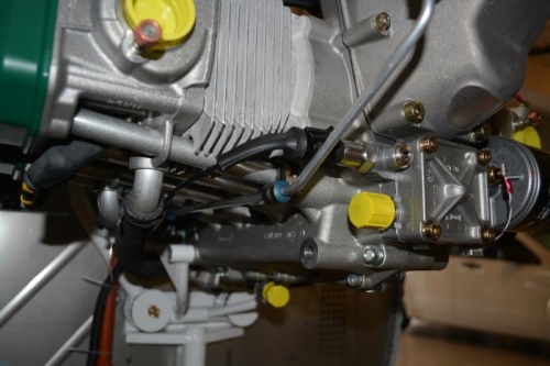

Brief Description:  Attach fuel drain line (46-16)
Now that the tube has been bent to the right shape, it’s time to attach it. This went fairly well but the Adel clamps were a little challenging. I decided to use the manual suggestion and wire tie them closed until I could get the bolt secured. Even with doing that it was hard to get the holes aligned in the Adel clamps. With a little force and some strong fingers and the help of a screwdriver, I was able to get the bolt through. The fwd side was easier to get to, but the aft side (luckily for me) seemed to line up easier.
fwd end fuel drain line
fwd cussion clamp
fwd cussion clamp
tight fit to get it past all the hoses
