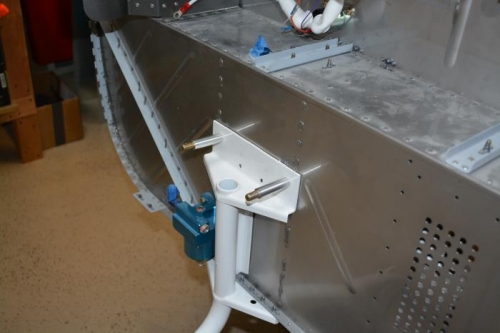

Follow the directions on final sizing the holes works pretty well. The only recommendation here would be to step up slowly to bigger drill bits to finally get to the 3/8" size. Otherwise the drill really wants to grab to much as it breaks through each layer. A little deburring and some general house cleaning in the shop and I have some more room to get the engine on.
Final size to 3/8
Final size to 3/8" holes for engine

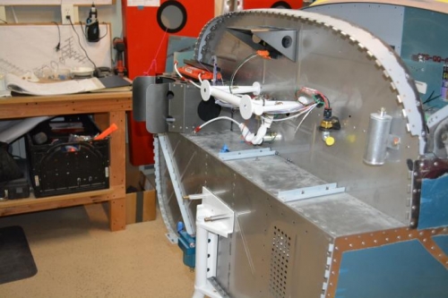

cleared wires tube out of teh way in prep for engine

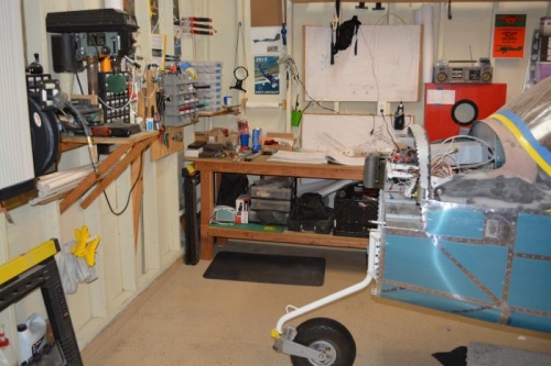

moved workbench to provide some more room
