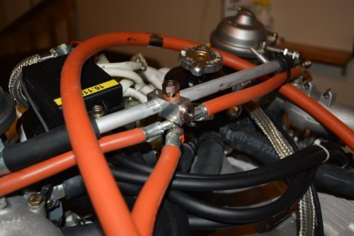

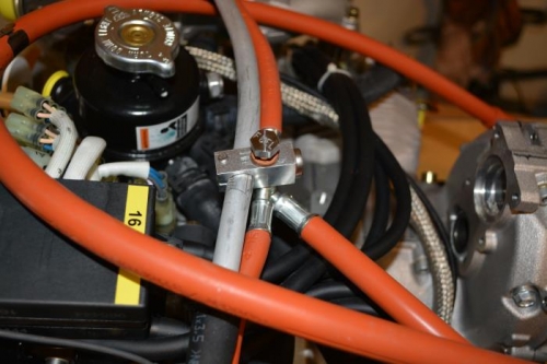

Brief Description:  Fuel lines and banjo bolts (46-07)
This took a little while to take apart the banjo bolts and flip the bracket to the fwd side. The bracket was really tight on the tube, so I ended up having to spread it apart a little to get it to rotate. I also recommend re-attaching the lower banjo bolt before final tightening the Allen bolt. The fuel lines are really stiff and the bracket may need to move a little to get it all back together. Anyway, that's done.
fule line bracket flipped 180 deg
all back together with a little effort
bolt and allen torqued as directed
