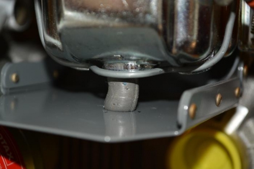

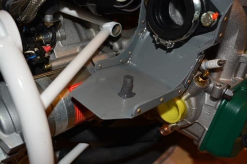

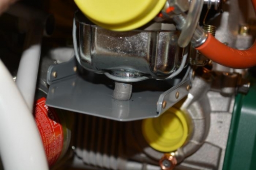

I still need to cut it down to size, but for now I just want to figure out the location on the tray, so I installed the carb over my homemade bridge and mark the location on the tray. Then I mixed up some more sealant and put it in place. At first I tried to apply sealant to both ends and install the crab at the same time, but the little cylinder just kept falling over and made a mess of the sealant...nasty stuff. I opted to just attach it to the tray for now, and then I'll come back and size it. I shouldn't even need to mix up any more sealant, since it's not supposed to stick to the bottom of the carb. I'll let this dry for now.
positioned the bridge under carb
marked the location on the tray
applied some more sealant to secure in place
