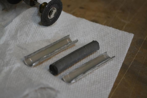

After the sealant set up, I carefully used the dremmel to cut the tube in half on both sides. I cut just deep enough to just get through tube wall, but not into the sealant. Once I cut both side it was easy to separate and ta-da, a perfect cylinder of fuel tank sealant. Now I just need to cut it to size and find a way to get it in place.
Note: this is not the final length of the cylinder bridge, but offered enough length so I don't have to add any more sealant to complete the bridge, other than stick it to the tray.
tubing mod cut away to yield cylinder

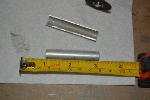

tube was about 2.25
tube was about 2.25" long

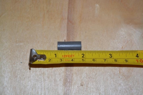

yielded two cylinders about 7/8
yielded two cylinders about 7/8" long
