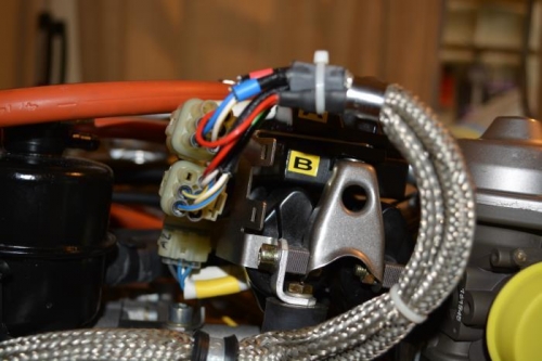

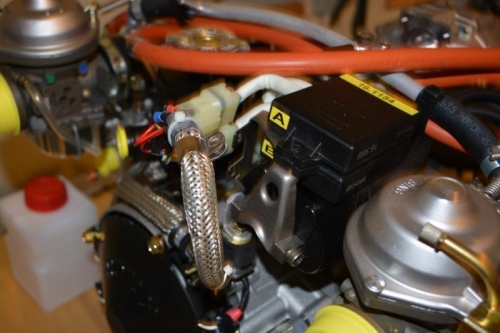

Disconnect engine ignition wires (46-02)
Again all this is to provide access for the engine support. Removal of the one bolt on the ignition box is just to allow it to flex a little later in the assembly process.
remove Adel clamp
Slide off wire connectors
remove one bolt from ingnition box
