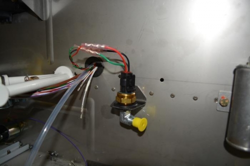

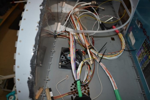

Well I started wiring the firewall fwd section. This whole section will be a little challenging since I don't have the avionics kit yet. Much of the items reference components that should already be installed. I will be trying to complete as much as possible, but not leave anything undone that will be too hard to do later (with the engine installed). So I hooked up the battery cables, attached the Master Relay, Starter Relay and Manifold Pressure sensor. Then I ran the wires through the firewall grommet. I don't have the Com Support Bracket installed yet, but I looked up what snap bushing gets installed and ran the appropriate wires.

Fuel pressure sensor installed
It looks like a mess, but there will be order someday
