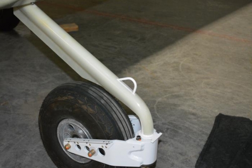

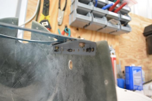

Continuing with fairing installation. The gear leg fairing went on easily and fit very well. The new longeron yoke worked well to install the brackets. The old design used a piece of sheet metal to bridge the gap between the fwd and aft section of the wheel fairing, but the new design has a flange built in to the fwd section (like the main wheel fairings). Since the flange is built in, the angle must be installed directly to the fairing, which is why the new yoke was required.
gear leg fairing test fit
angle bracket installed
new yoke worked great for angle bracket
