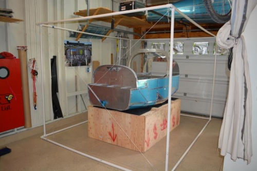

I started with 1" pvc pipe to build the perimeter, then added some string from some cross braces. I plan to add a fan to pull the air out to create lower pressure on the inside. I'll add an air filter to allow air top come in.
Looks small, but I'm only painting the interior

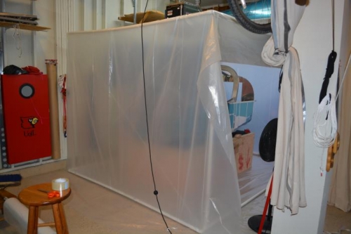

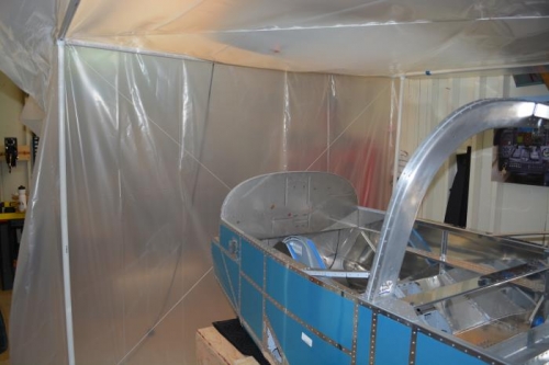

Starting to wrap in 6 mil plastic
now it's looking realy tight
