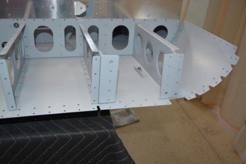

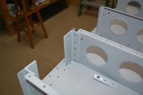

For the narrow brackets i had to use a socket to fit in the gap and clamp in place. For the step angles I place the rivet head on the thinner metal of the ribs. I deburred all the step angles and primed everything prior to riveting.

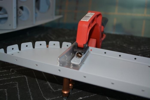

Used a socket to clamp the nutplate bracket while drilling the #30 hole
