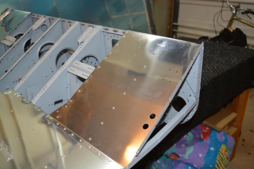

No issues with the seat ramps. I've making sure to use my steel spacer when setting the CS4-4 rivets to keep them smooth and flush.
Added seat ramps.

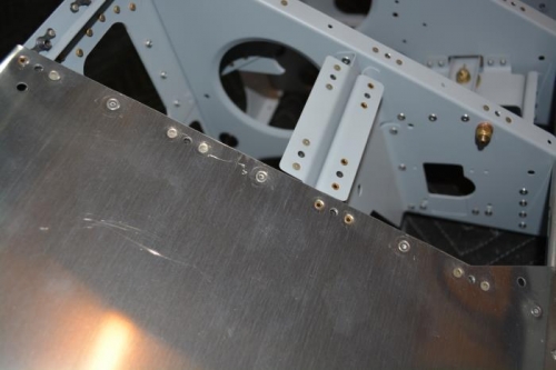

Needed to apply some pressure to get the flange to lay flat prior to setting the rivets

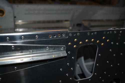

Nut plates added.
