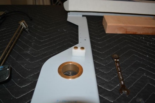

Primed and prepped the side bulkhead and final drilled the # 11 holes as instructed. I torqued the bolts to about 25 in-lbs over the running torque, and then applied torque seal.
Attached retainer nylon block

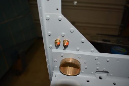

Torqued bolts for retainer nylon block

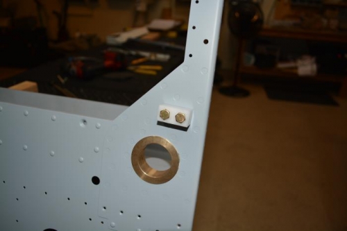

Front view of retainer nylon block on bulkhead
