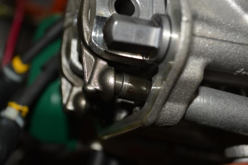

Following the instructions from Rotax for SB-912-070UL, the valve covers were removed and the push rod ends were inspected. All four valve covers were removed and all eight pushrods were inspected and found to comply with the acceptable requirement (silver ends on push rods).

All 8 pushrods checked OK (typical picture shown)
