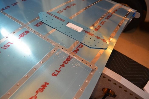

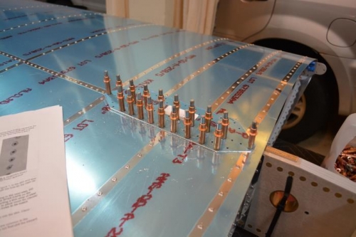

Started working on the service bulletin (SB 14-11-03) for the right wing). Carefully removed the inboard 20 rivets attaching the W-1201-R inboard wing skin to the flange of the W-1206A-R spar assembly and the single indicated rivet attaching there skin to the W-1210 main rib per the directions in the SB. I didn't have a punch the right side, but using a mandrel from the left over pulled rivets worked well to drive out the mandrel from each of the installed rivets. Then drilling out the rivets was easy. Next step is to match drill the holes, but waiting on a #22 size drill bit from Avery. This was not included in the original tool kit. I also took the opportunity to purchase a chip chaser.

Removal of wing spar cap rivets per SB 14-11-03
Match drill additional holes per SB 14-11-03
