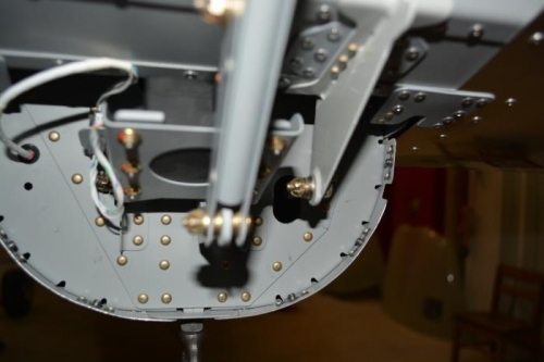

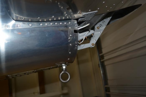

This is another project that I’ve been putting off…tail cone attachment. The plate nuts were a little tricky to drill and install. For a couple locations I had to use the dimple dies with channel locks to get the dimples completed. I also ended up taking the rudder off in order to get the squeezer to work. It’s all done except I need to reinstall the rudder and final torque/cotter pin the nuts before closing it up with the tail cone.
rudder removed and plate nuts set

ready to install tail cone
