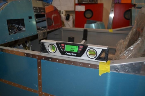

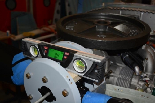

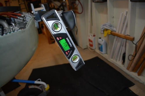

Before I could finish the spinner I needed to set the propeller blades to the right angle. This first requires making sure the plane is level, which required a little help. The plane as a little tilted toward the tail section, so I added a weight to the engine and lifted the tail slightly. Next was to level the housing assembly, then rotate the prop until I got to 71.4 deg. It took several iterations to get it to read the right angle even after I tightened the bolts, but I’m happy with the results.
plane level
plane level
propeller housing level
propeller set to 71.4 deg
