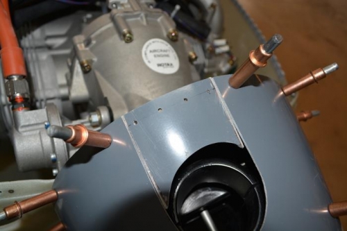

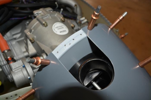

Brief Description:  Install spinner gap filler (47-05)

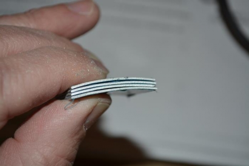

I worked on installing the spinner gap filler. I checked the fit and clamped the gap fillers in place. The directions don’t say how to space the holes, but I think I offset the outside holes a 1/4” from the edge and then equally spaced the other holes. I also created the back plates for the gap fillers. The direction say to pre bend before cutting and I started with a tuna can which matched the spinner shape well, but when I cut the first one it was way too flat. I ended up using a can of cooking spray to get the right curvature. O marked all the tabs and trimmed the edges to keep it from sticking out. All the pieces of the spinner are marked so I keep the right orientation.
Holes drilled for spinner gap filler
spinner gap filler with holes drilled
created back plate tabs for gap filler
