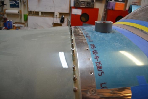

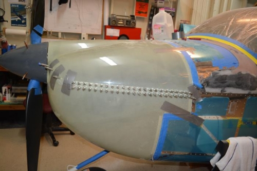

Brief Description:  Drill hinge attachment holes (38-06)
I set the side hinge pins to the length I wanted based on the distance from the hinge. I tried using the intersection point, but that put the screw location pretty far forward. So I opted to set them about a ½” in front of the hinge. This required a little bit of a goose neck bend to the pin to get it to sit flush, but overall it looks better…I think. I then taped everything down into position and started drilling all the holes. It was a lot of holes and more clecos than I had, so I had to start steeling them from other hinges as I went along. It helped to pull on the neighboring clecoe while I drilled, so the hinge wouldn’t push away too much. There are a couple places I wish the fit could be better, but I was done playing with it and I was a risk to just make things worse. It’s amazing how solid this flimsy fiberglass cowling feels, now that it is attached.
hinge pin in place and knotch cut out
left hinge drilled and clecoed in place
Upper cowling holes drilled
