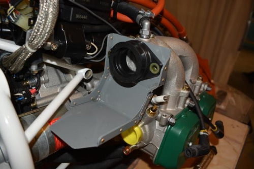

Brief Description:  attach drip trays (46-06)

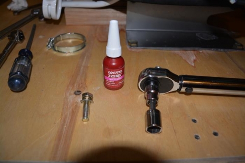

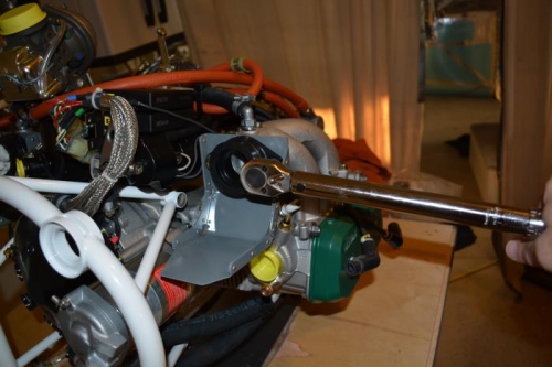

The directions call for Loctite 221, but Loctite 222 seems to be the latest version and is the most readily available. This is a light duty thread lock (purple). Once the drip tray was installed I locked it down to 125 in-lbs as directed and added some torque seal to indicate it was complete.
drip trap in place
drip trap in place
add thread lock
add thread lock
torque as directed
torque as directed
