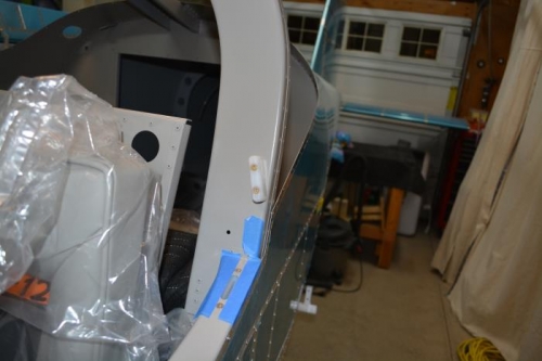

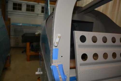

After crashing down the canopy on the roll bar, I decided to install the guide blocks to reduce the risk of doing it again. I used the drill press to drill a #30 hole, and then follow that with the #19 with just the hand drill...which seemed to work nicely. I used the micro counter sink tool to get the right depth for the screws. The directions say to radius first, then counter sink. I tried it both ways and I think it worked better to counter sink first (while the surface is flat, then add the radius. I ended up using the dremmel with a fine grit drum sander to put in the radius (started with a chamfer, then finished it off to a radius). It still looks a little rough, but I couldn't think of a better technique to get the radius on...unless I had a milling machine or fancy router....which I don't. After getting the blocks installed and trying the canopy, I had to do some additional whittling to get it to clear the screws on the corners of the canopy (the ones we had to cut off the extra threads).

left side installed
left side installed
right side installed
