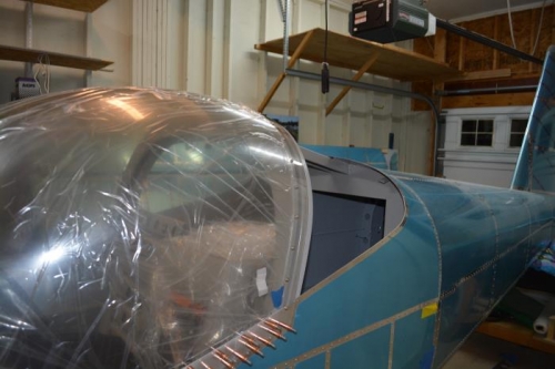

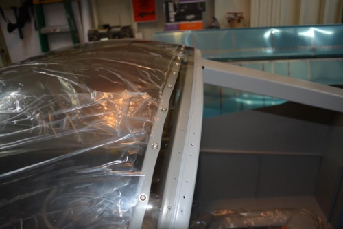

Brief Description:  Attaching canopy to rear frame (34-09)
I spent a couple days researching the hole drill size. The screws defined in the instructions don't fit into a #30 size hole. The holes in the plexi-glass are fine (#27), but the holes in the frame are all #30. After reading up on it I found that the recommendation was to drill the holes to a #29. So I carefully drilled each hole and use the air gun to clear away any shavings from getting pinched between the plexi-glass and the frame. I then very slowly attached each screw, washer & nut using hand wrench and Philips head. I only tightened until I saw/felt that the screw head was seated, but could spin with almost no effort from the Philips head screw drive. I also noticed that I installed the washer on the wrong side. (I’ll fix that another day)
canopy screws attached to rear frame bow
screws barely tightened to allow canopy to move
