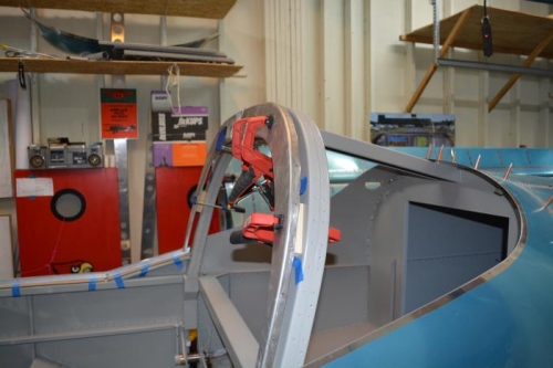

I fluted the side angles to line up, and the match drilled the holes into the frame (clecoed as I went).
canopy framed clamped in place

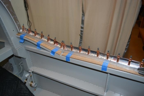

positioned the side angle, drilled and clecoed
left side ready to deburr and rivet
