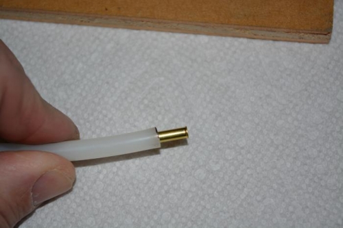

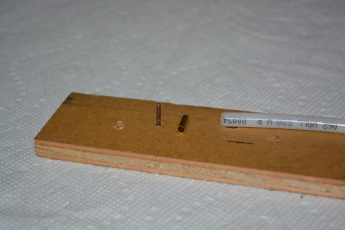

This is the little jig I came up with to help get the sleeve part way in. Without this it wants to slide off to the side and usually shoots across the workbench. This holds it upright in place while I slide the tube down and I don't have out worry about it shifting an flying off. I was able to get it into the tube just enough so that the collar would just fit right into place...about 1/8" from the end. Anyway, it worked out well for me.
Used a small nail to help hold the inner sleeve upright for the tube to slide down on
slide the sleeve over the nail, then pushed the brake line tube over the sleeve
Now it's on and ready for some hot water to get it all the way in
