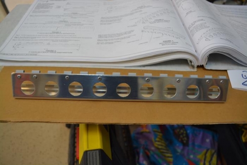

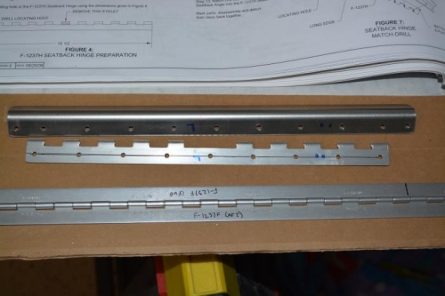

Completed match drilling the holes, primed the hinges and angles that were in contact with he seat back and started riveting. Also final sized the #12 holes.
Hinge holes complete
F-1237F (Aft) riveted in place
#12 hole drilled for AN3-4A bolts
