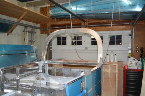

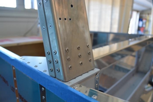

Brief Description:  Rivet roll bar to bases (24-03)
I used the boelube again to help slide to roll bar on and the wing nut clamps to pull everything tightly together. The riveting went nicely. I used the hand puller here and the pneumatic for the roll bar.
Riveted roll bar to left base
backside view

roll bar complete
roll bar complete
