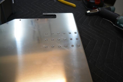

Brief Description:  Attached Engine Mount Brackets (22-02)
Used the same technique (see previous post or in the 1st picture) to secure the tunnel panel to attach the nut plates. Also, attached the engine mount brackets per step 4. I've been trying to leave the surfaces that will get painted with interior paint un-primed so I can prime with the "good" stuff later on, but it’s tricky to figure out what surfaces I will still have access to once everything is assembled. Anyway, I primed the interior of the tunnel panels, but not the exterior.
Primed and attached the nut plates to the tunnel panel
