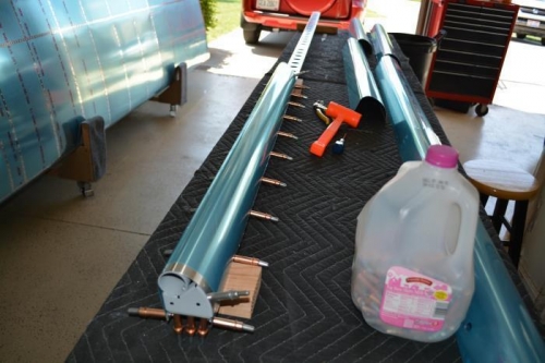

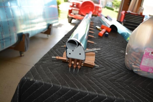

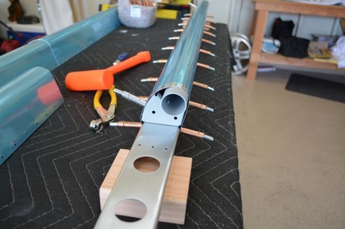

Prepared the A1201C-L skin, deburred the edges and holes and removed the film around the edges. Next clecoed everything in place to get it ready to drill the holes along the leading edge into the counterbalance. After my experience on the two outside edge holes, I will mark the holes and use the drill press to do the final drilling. The hand drill tends to walk around on the steel.
Cleco the A-1201C-L and counterbalnce assembly in place
Prepr fopr drilling counterbalance
Another view
Another view
