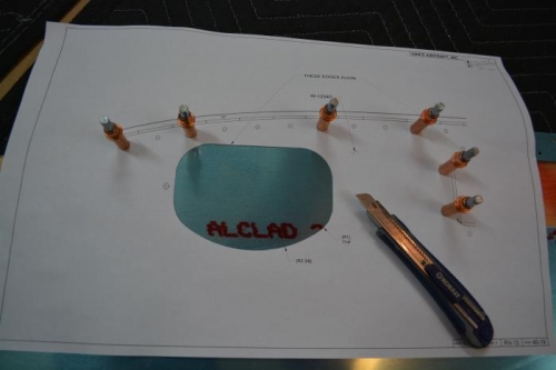

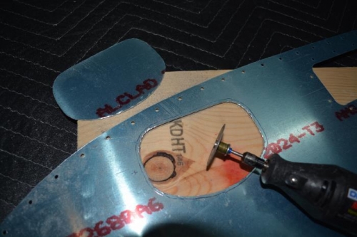

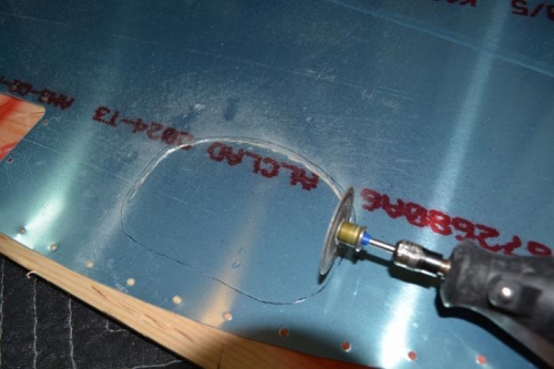

While I'm waiting for the replacement skin, I decided to get a jump on cutting the hole for the right wing tip light access opening. First I laid out the template and traced the hole with a razor knife and scratched an "X" at each hole location per the template. Then I roughed out the hole shape with the dremmel.
Lay out template for right wing access opening
Use cut-off wheel on the dremel to rough out hole shape
Access hole roughed out
