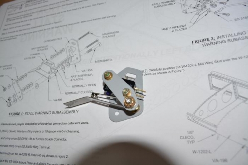

Brief Description:  Stall Warning Assembly (16-02)

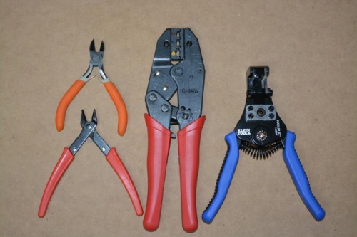

Drilled, counter sink, deburred, primed and assembled stall switch. Also spent some times shopping around for the right tools and watching instructional videos on how to prep and crimp the wires. The generic crimper I had looked like it more like a cruncher and not a crimper, plus it didn't do both crimps at the same time. The crimp on the wire is supposed to be tighter than the one around the insulation. Instead of taking a chance I decided to do some shopping on line. After a little while and seeing ratcheting crimp tools up to as much as $75, I found Harbor Freight had one for just $14 that worked just fine. I did end up getting an auto stripper at Home Depot that is really cool.
stall switched assembled
Reverse view
Reverse view
Tools needed in prep fro wireing
