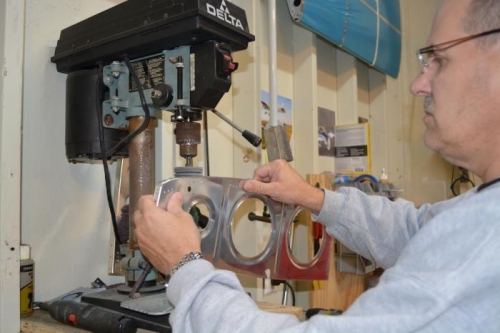

Deburring wing ribs (15-02)

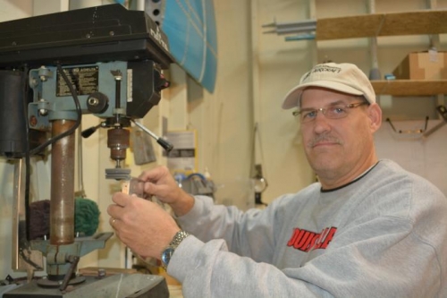

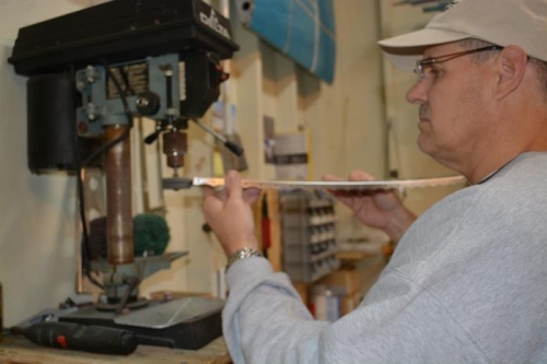

The scotchbrite wheel works for almost the whole rib including the holes. Just need to keep a steady hand or I will be eating one of those ribs.
2" wheel fits the flange scallops nicely
working my way around with the scotchbrite wheel
Actually works prety good and saves a lot of time
